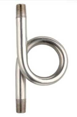

In steam service, the common practice is to install coil siphons or pigtail siphons to dissipate process heat. Another common practice is to install a diaphragm seal with capillary to separate the gauge from the high heat source. Many options are available with fill fluid in the seal and capillary system to withstand temperatures to 600 °F.

A pigtail siphon can be used to help dissipate heat between a hydraulic system and the gauge — provided ambient temperature is low enough.

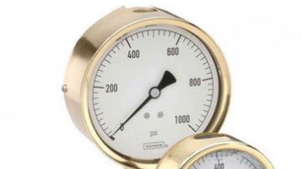

Vibration from pumps, motors, and other rotating equipment can accelerate wear and premature failure of internal working parts of a pressure gauge, especially the Bourdon tube and the gear and movement mechanism. Vibration can also cause pointer oscillation, which makes it difficult to obtain an accurate reading. One of the most common causes of pressure gauge failure is exposure to continuous vibration.
The most widely accepted remedy is to utilize a liquid-filled pressure gauge. The fill fluid of choice is either glycerine or silicone. Liquid-filled gauges address not only pointer oscillation, but also serve to protect and lubricate the internal geared movement.
