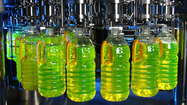

Many manufacturing systems, such as the blow-molding operation for plastic bottles, extensively use pneumatic switches and sensors to monitor and control the mechanisms that assemble or form a product and transport it down the line. (Image courtesy of Paula Hynes, Rodon Group)
