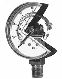

    Gauges using C-shaped Bourdon tubes as the elastic chamber, as shown above left, are by far the most common. Pressurized fluid enters the stem at the bottom (which is sometimes entrancement instead) and passes into the Bourdon tube. The tube has a flattened cross section and is sealed at its tip. Any pressure in the tube in excess of the external pressure (usually atmospheric) causes the Bourdon tube to elastically change its shape to a more circular cross section.
    This change in shape of the cross section tends to straighten the C-shape of the Bourdon tube. With the bottom stem end fixed, the straightening causes the tip at the opposite end to move a short distance — 1/16 to 1/2 in., depending on the size of the tube. A mechanical movement then transmits this tip motion to a gear train that rotates an indicating pointer over a graduated scale to display the applied pressure. Often, a movement is incorporated to provide mechanical advantage to multiply the relatively short movement of the tube tip.
