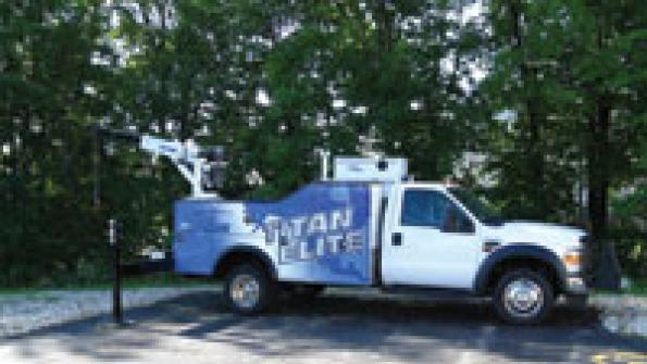

Auto Crane’s truck-mounted telescopic and articulating crane features redesigned hydraulic and control systems that improve productivity, safety, and ease of operation and troubleshooting. Courtesy GS North America
Auto Crane Co., Tulsa, Okla., developed the very first auto crane in 1958 by placing a crane in the trunk of a car. This work-truck industry pioneer has since produced some of the most reliable cranes and crane-service bodies in the industry and now offers models with lifting capabilities to 14,000 lb.

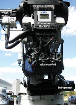

GSNA and Magnetek provided the totally new crane control and operating systems that offer fully proportional hydraulic valve control, including multiple speed scaling and the ability to operate multiple functions of the crane simultaneously. The new system is comprised of three major components: the hydraulic system, the hand-held transmitter, and the receiver.
Level, pressure and proximity sensors measure positions, determine loading, and monitor speeds of critical machine functions. I/O modules provide electrohydraulic proportional control of the crane functions. The wireless controller is integrated with the vehicle’s CAN, including operator control.
GSNA provided custom hydraulics that include the industry’s first J1939 boom angle sensor with truck frame level monitoring. The hydraulic system valve bank from GSNA allows individual crane functions to operate in parallel, so each function can operate independently and without flow degradation inherent to series systems. This means the operator can extend or rotate the boom and lift at the same time. The valve bank provides 100% proportional control for all crane functions, eliminating uncontrolled swings and boom jerk. The multi-speed control scheme is an industry first and allows for multi-function creep control on the transmitter and speed scaling functionality on the control.
Each function is individually infinitely variable and allows setting ramp rates of the boom, telescoping cylinder, rotation, and hoist independently and controlling mass acceleration of the system. Maximum speeds of each function also can be independently set.
The new hydraulic system allows scaling speed and performance through the entire load range of cranes rated from 5000 to 14,000 lb. One valve bank is used through Auto Crane’s entire product range with the only change being the electric current parameters set through the control. Every crane has its own control profile, which is pre-loaded into the controller. The controller’s ability to read and match the correct control profile for each crane is where the marriage of the hydraulics and electronics excel.

Magnetek also provided the receiver, its Enrange MHR wireless controller. It combines the components of a radio receiver and hydraulic controller into a single unit that significantly reduces costs and frees up valuable space on the trucks. It manages the output to the hydraulic valve bank as the transmitter is actuated. This ensures repeatable and constant performance at all temperatures and loads. The result is smooth ramp up and ramp down of each crane function independent of any other functions.
An LCD screen allows viewing system settings and a series of readouts that monitor the overall operation of the system — another first in the truck crane industry. Initial concern that the screen might not withstand the harsh, outdoor environments of the field were squelched after repeated shock and impact testing proved the LCD’s durability. The LCD allows diagnosing problems accurately and quickly because it shows more than just alpha-numeric status codes — actual descriptions are clearly spelled out.
The diagnostic system monitors all aspects of the machine functions, including boom angle relative to ground position, hydraulic pressure, winch status, and proportional outputs status. This closed-loop system also senses one of the biggest failures in the electrical system: cable failure. Indicating the status of the cable and the coil on the hydraulic solenoid can help an operator diagnose the source of a crane malfunction in 5 sec or less. The diagnostic system also provides preventive maintenance indication, error event logging and messaging.
