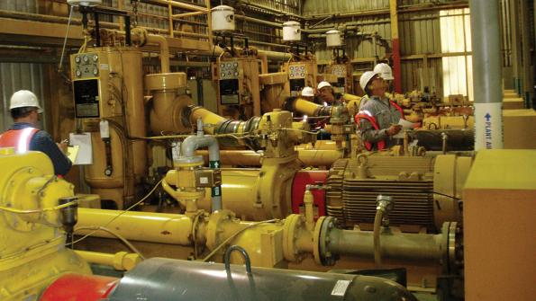

A typical plant has several compressors. A compressed air system controller with pre-emptive control capability helps them run most economically. Photo courtesy of Roseburg Forest Products.
