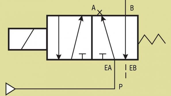

We had a pneumatic nut runner on trial in the field using a standard 5-port spool valve plumbed as a 3-way valve — not an unusual arrangement. We got an emergency call from the production people there. A product redesign called for a different nut, and the operation with the new nut was too slow.
They calculated that they needed twice the flow to meet the time requirement. However, the existing valve was already flowing near its maximum capacity, and space didn’t allow for a bigger valve. Could we help? Quickly?
We dug out the catalog on the valve and were delighted to learn that it was a multipurpose design — it could accept pressure at any port. This meant it could perform like two 3-way valves in the same body.
We told our field people to install larger supply lines and bring air into ports A and P. Then we told them to tee lines from ports B and EA together, and connect the combined flow to the nut runner.
They did as we suggested, and the valve performed as predicted, putting the nut runner back in business.
