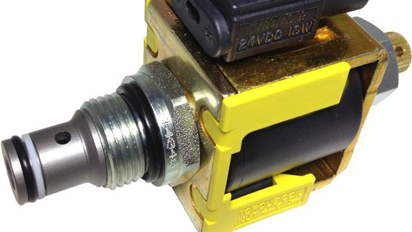

Two new components in the logic element arsenal are normally closed, vent-to-open type of logic elements (such as Comatrol’s HLE10-CVO and its family) and proportional relief valves (like the HPRV08-DAC and its family).
Proportional pressure relief valves (PRVs) are two-way valves that provide a relief pressure as a function of electric current. Both normally open (increasing pressure with increasing current), and normally closed (decreasing pressure with increasing current) are available. Considering the growing potential of proportional control hydraulic fan drives, we’ll use a normally closed design for fan speed control as an example.

Normally closed proportional relief valves are available in direct-acting and pilot-operated designs. A direct-acting, normally closed proportional relief valve is used for low-flow applications, like piloting a logic element. For high flow applications up to 180 lpm, internally pilot-operated cartridges are available. If the flow or pressure requirements exceed that of the internally pilot-operated valves, then combining the direct-acting PRV with the proper logic element is the next logical step.
Common applications for normally closed proportional relief valves are electroproportional control of system relief pressure or a remote pressure compensator control for open circuit piston pumps, but where system requirements dictate full pressure with no electrical signal. Most fan drive systems require the fail-safe mode (no electrical current) to provide full fan speed, which makes normally closed PRVs ideal.
