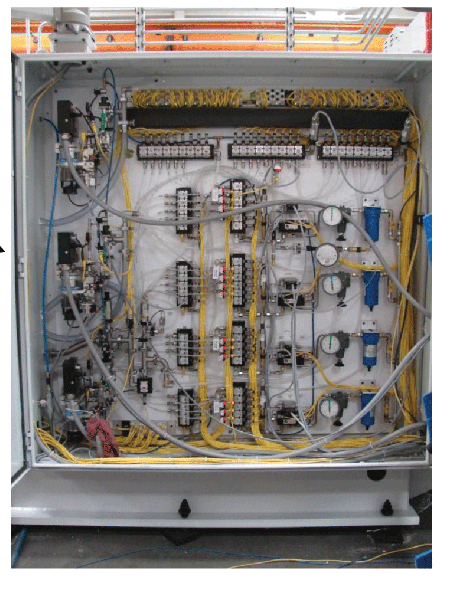

Ross Controls Dale series valves were used successfully in a helium leak test system that requires absolutely leak tight valves. The pneumatic system has 11 Dale CX manifolds with more than 80 valves and four LT leak test manifolds with sensor ports.
