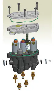

Multi-function valve block
Electronic control of individual valves offers all the benefits described above, but integrating multiple valves and other components into a single cast-aluminum housing or manifold significantly enhances the value of the system. This is clearly seen in the example of the multi-function control valve block (MCVB) for controlling turbocharger waste gate emissions and exhaust brakes in heavy-duty truck engines.
Previous designs relied on standalone valves, each with its own housing, pneumatic connections, wiring, and mounting hardware. The new version consolidates several proportional valves, a pressure regulator, pressure sensor, and all the associated fittings into a single cast-aluminum housing with one connector.
The MCVB magnifies the advantages inherent in electropneumatic control systems. It is easier to install a “plug-and-play” unit than individual valves. Fewer electrical and pneumatic connection points mean fewer chances for installation errors and leaks.
The unit’s rapid-response valves adjust the air/fuel mix quickly to control emissions while still giving the driver the engine response and power required. And the high-accuracy valves deliver precise positioning, so the electronic controller does not need to continuously make corrections and adjustments.
This exploded view shows consolidated multiple proportional valves, a pressure regulator, a pressure sensor, and all the associated fittings into a single cast aluminum housing with a single connector.
The integrated unit uses common input and exhaust circuits. And it consolidates four modules into one – reducing the total number of components by 30%. The MCVB also requires less mounting hardware and has a significantly smaller footprint, compared with individual valves. This gives designers more options for placement and more space for other equipment.
Mounting components into a single unit has another advantage: Instead of qualifying each component and validating its performance, the MCVB comes as one comprehensive, pretested unit.
