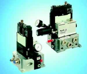

Series 261 plug-in valves, shown in ISO sizes 2 and 3 with a sandwich regulator, substantially reduce compressed air consumption when compared with conventional valves. Key features include a packed spool rather than metal-to-metal sealing, and a regulator that differentiates forces for push and pull cylinder strokes.
Pneumatic directional-control valves with metal-to-metal spool seals are plagued by significant and constant leakage, even when the valves are not in use.
