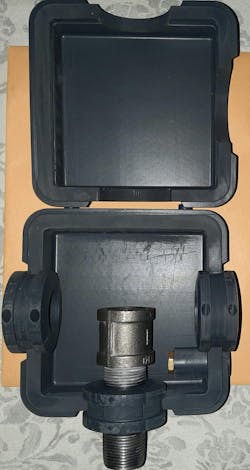

The Clamshell Box System is engineered to provide a reliable and adaptable solution for repairing leaks in the air systems at manufacturing facilities. It functions by clamping grommets and the box around leak areas, typically at pipe joints, to contain the leaks.
The clamshell box is then securely closed using an electrofusion process. This process utilizes an embedded copper coil that is situated near the mating surfaces of the clamshell box halves which melts its two halves together, forming a fused, single part. This fusion extends to the grommets, which also melt to the box, creating a monolithic, hermetically sealed structure.
Primary components of the two-part clamshell box are fabricated from high-density polyethylene (HDPE) or a similar polypropylene composite material. This material was chosen for its structural rigidity, chemical resistance, and suitability for electrofusion.
Two ports are included on the clamshell box, similar to those on electrofusion polypropylene pipe connectors, to which an industry-standard electrofusion machine is connected. In addition, the box features an interior clip system that holds it closed together once positioned. This system ensures proper alignment of the mating surfaces and securely seats the box onto the grommets.
The system’s grommets are designed to directly interface with pneumatic piping and are also constructed from high-density polyethylene or polypropylene material to ensure material compatibility for thermal fusion with the clamshell box halves. Each grommet half incorporates a pre-installed sealing gasket on its interior radius made from a resilient elastomeric material, such as nitrile rubber or EPDM (ethylene propylene diene monomer rubber), selected for its compressibility and ability to form a fluid-tight seal against a pipe surface.
Grommet halves are secured together using standard machine screws, typically fabricated from stainless steel for corrosion resistance.
A safety valve, rated for a maximum of 200 psi, is incorporated into one of the clamshell box halves as well to prevent air pressure buildup inside the box during the electrofusion process. The valve body is typically constructed of brass or stainless steel to ensure its durability.

Prior to final assembly, one half of the clamshell box can be used as a template to verify the correct spacing and alignment of the installed grommets. Each grommet features an exterior circular channel designed to mate with a corresponding feature inside the clamshell box. It is recommended to check alignment with one half of the box first.
  • Once alignment is confirmed, the two halves of the box are taken and clipped around the joint and around the circular channel of the grommets.
  • The box's integrated clip system will hold it closed. Once fully closed, the clip system cannot be unclipped, and attempting to forcibly open it will result in damage or breakage to the clips, emphasizing the need for proper initial alignment.
