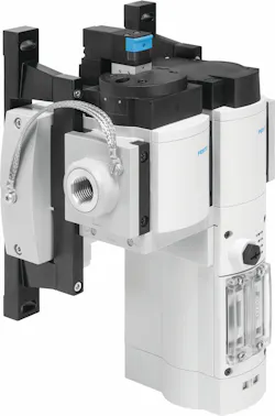

Today the information coming from devices is used to not only detect failures but also predict them. The Festo series of energy efficiency modules MSE6 was developed with the focus on reducing compressed air leakage by monitoring the flow and pressure profile. When a machine idle state is detected, operators can set the MSE6 unit to automatically regulate air down to a preset lower level or to 0 if desired and save energy.
Additionally, the pressure, flow, and air consumption data can be captured, stored, and analyzed to give the company insights into ongoing energy consumption.
