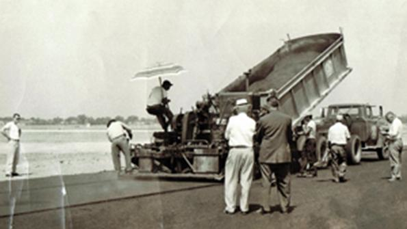

50 years ago in Hydraulics & Pneumatics — May 1964 The May 1964 issue of Hydraulics & Pneumatics described an asphalt paving machines rugged enough to withstand severe jarring of trucks backing into them, yet sensitive enough to produce smooth, even surfaces. A good, finished surface must be true to grade (elevation in the longitudinal direction) and transverse slope.
The electrohydraulic paver-finisher uses electrical signals to control the machine’s paving elevation through hydraulic valves. A sensing device rides on reference surfaces to measure grade and maintain slop relationship. Signals from the grade and slope sensors actuate two solenoid valves. These valves control cylinders that control the paver screed elevation and slope with respect to the reference. Four-way, 3-position, open-center, solenoid valves were selected instead of electrohydraulic valves, because they provide required positioning accuracy, produce less heat, and are readily available as off-the-shelf items.
One system controls grade, another controls slope. Both systems are supplied by a fixed displacement, belt-driven, gear pump delivering 1 gpm at 1000 psi. The pump is part of a package, which includes a reservoir, filter, and a flow control valve, which insures constant flow regardless of engine speed.
