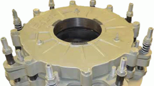

Eaton’s air-cooled, spring-applied, pressure-released AirFlex brakes (above) solved maintenance problems on this dragline excavator (below).

Eaton supplied its heavy-duty, air-cooled, spring-applied/pressure-released Airflex 138FHB (floating housing brake) as a replacement. This patented braking concept employs a floating housing instead of a floating rotor. The disc brake’s full 360° annular disc extends friction pad wear life. And with this brake’s configuration, friction pads that can be changed in less than an hour … instead of 3 hr or more for alternative designs. Eaton’s “pizza-slice” configuration allows easy access to the friction pads, eliminating the old system’s need for a complete teardown just to replace a pad.
The 138FHB’s design not only reduces the time for each replacement, but the organic friction material also reduces the overall number of friction-pad replacements required. Instead of as many as six times per year, as claimed by a coal mining operation, the 138FHB’s friction-pad replacement is projected to be required approximately once every

As for major maintenance, dragline service providers estimate that drum removal is needed every two to three years. With clamshell brakes, this procedure requires heating equipment, a hydraulic press, and a full day of labor and downtime. Eaton’s TSL (tapered shaft-lock assembly) allows for faster and safer brake installation — without the need to heat and remove the drum with a hydraulic press. This not only saves time at installation, but also for routine maintenance.
In addition, the design combination of a TSL, solid rotor, and stationary friction material removes many of the wear issues associated with spline-and-gear designs. For example, the fixed hub and rotor eliminate wear during freewheeling.
Sheerness Mine’s maintenance supervisor and staff are impressed with the performance of the138FHB. “The brake is very robust,” said Spies. “It is serviceable if needed and runs well.”
