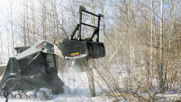

Erskine Attachments builds attachments for skid-steer loaders, compact tractors, and excavators. The firm’s heavy-duty forestry-mulcher attachment cuts, clears, and grinds brush, trees, and other vegetation. The attachment can be used for breaking trails, leveling building sites, and removing storm damage. The mulcher housing contains a 14-in. diameter, 60-in. wide rotary drum fitted with 30 double-helix, carbide-tipped steel teeth designed to pull material toward the attachment, where it is shredded.
The Erskine forestry-mulcher attachment is shown here mounted on a tracked Terex PT-100G loader.

The 2,450-lb Erskine heavy-duty forestry mulcher attachment cuts a 60-in.-wide path. Its variable-displacement hydraulic motor accepts flows from 33 to 41 gpm, allowing it to run off the hydraulic systems of most high-flow skid-steer loaders.
