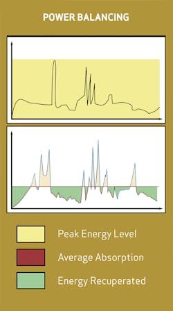

The DE2020 works in a similar manner, absorbing short-term energy bursts which occur during use of the Gen3 motion system. Energy is stored in the Gen3 motion base’s capacitor banks and used when necessary to meet peak load requirements.
Moog says this design eliminates the need to size electrical power to handle peak loads, helping to streamline cable design and power connections for the Gen3 motion system. It also helps to save energy and reduce costs.
Chiodi says that because the DE2020 constantly manages energy intake it safeguards industrial applications from power fluctuations or power losses which could cause damage or interfere with operation.
According to Moog, the DE2020 can also be used to compensate for fluctuations by using a pre-filter in combination with the capacitor bank. In the event of a sudden power failure, the DE2020 can supply the Gen3 system with enough energy to reach the safe return to home position as well.
