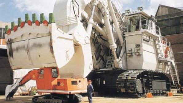

These advancements continue today with ever-increasing power capacities, higher reliability through improved filtration and diagnostic techniques, higher energy efficiency by implementing load-sensing circuitry, and enhanced operation through electronic control. Perhaps nothing better illustrates the strides achieved in higher power capabilities for mobile equipment than the photo at right. It shows one of the first all-hydraulic excavators dwarfed by the largest built to date, the RH400, designed and built by Orenstein and Koppel AG, of Berlin, Germany. The hydrostatic drives, implements, and other systems are powered by a pair of Cummins 2700-hp QSK60 diesel engines. The hydraulic systems are supplied by 18 variable-displacement, axial-piston pumps, eight of which are Model A7VSL1000HDs from Mannesmann Rexroth.
This earthmoving giant was delivered to Syncrude Canada Ltd., Fort McMurray, Alberta for its new North Mine project. A total of four RH-400s are used for mining oil sand, which is trucked to crushing stations and eventually mixed with hot water to form an oil sand slurry that is pumped through a pipeline to an extraction station. The process is expected eventually to produce 82 million barrels of oil per year. When the project reaches full capacity, in 2006, the four RH400s will deliver oil sand to as many as 30 trucks, each with a capacity of 320 tons. It takes only four passes of an RH400 to completely fill one of the trucks. The high reliability and efficiency of the RH400's hydraulic system, combined with other advancements, will enable production to increase while decreasing operating costs. In fact, officials project that the North Mine project will use 15% less energy than had been consumed by its predecessor, the East Mine.

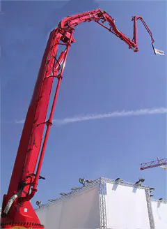

At 55 m (180 ft), Putzmeister's M55 has the highest vertical reach in the world for an articulated-boom concrete pump in the world, thanks, in large part, to lightweight hydraulic cylinders..
