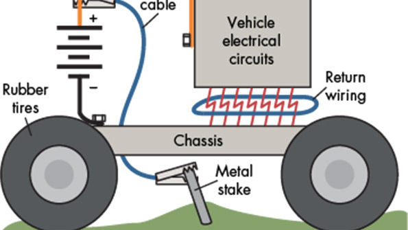

There’s a common misconception that ground (earth) somehow will suck up any electricity thrown at it. It’s simply not the case. Rather, it’s merely one conductor in the electrical power grid, because many years ago, the power industry chose to connect one side of its alternators to earth.
I often ask my students, "What would happen if you took a metal stake, drove it into the ground about two or three feet, and then connected a jumper cable from your car battery's positive terminal to the stake?" The answer is “nothing,” as can be seen in a simplified schematic of the automobile and its electrical system (Fig. 7).
7. The rubber (insulating) tires isolate the positive terminal of a vehicle’s battery from earth and the vehicle chassis.
The reason is that no complete loop is formed between the positive battery terminal, through the blue jumper cable, through the stake, and then through earth — which is the end of the circuit. The electrical circuit is open. The tires, being electrical insulators, prevent any current from flowing through the jumper cable and earth. If you decide to try this experiment, make sure it's done with a car with tires. If it's sitting on rims, there could be a complete current loop, i.e., a closed circuit loop.
While we’re on the subject of automotive electrical systems, SAE J1908 (a standard for vehicle grounding) allows for three different ground points in a vehicle. They are distinguished, one from the other, by the amount of current that each is allowed to carry. Ideally, there would be only one ground, requiring all return connections to be terminated at the negative terminal of the battery. Its impracticality becomes immediately apparent, so the vehicle’s body parts serve as the common return, i.e., vehicle ground.
The bundle of connections in Figure 7 labeled “Return wiring” suggests at least two different grounding points, one being inside the box labeled “Vehicle electrical circuits” and the other being the chassis. The one heavy
black return cable would likely be for the starter, which needs huge currents compared to, say, the radio.
The starter serves as a special case in point. Sometimes that heavy black connection is made within the starter housing itself, and there’s no external ground cable. The starter motor connects to the chassis initially with the internal starter ground connection. The starter also bolts to the engine with steel (conducting) bolts. Lastly, the engine bolts to the chassis, completing the circuit.
In other cases, shock-absorbing mounts support the engine and drive train, electrically isolating them from the chassis. A grounding strap and uninsulated, vibration-allowing cable (braided copper strands) connect the drive train electrically to the chassis. That strap completes the connection to the battery’s negative terminal.
