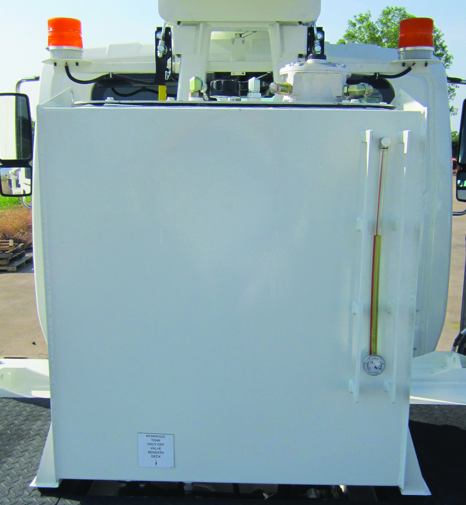

This 109-gal capacity hydraulic oil reservoir is fabricated from aluminized steel and is used in an aerial work platform bucket truck. It includes a sight gauge, filler-breather and filter.

This utility truck uses hydraulics to power and control its aerial work platform. The hydraulic system's reservoir, manufactured by IFH Group, is made of aluminzed steel to resist corrosion if moisture enters the hydraulic system.
