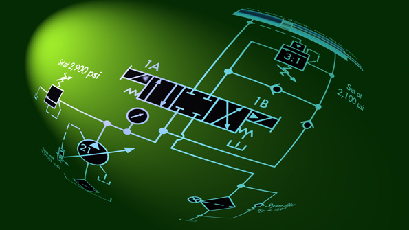

A molding machine using a regenerative unloader circuit was opening and closing at twice the closing speed rate, and attempts to fix the problem were unsuccessful.
Oct. 6, 2016
2 min read
An older molding machine was being used to debug new dies. The opening and closing time for the machine had increased to twice its normal high-speed closing rate. However, the tonnage when clamped was still working fine.
The circuit used a Sun Hydraulics counterbalance valve as the regenerative unloader. Unfortunately, as is too often the case, the first thing the mechanic did was replace the pump, which didn’t solve the problem. Next, the Sun counterbalance valve was replaced. The maintenance people felt if they adjusted it as high as it would go clockwise, the high-speed regeneration circuit should work all of the time, and they would see half the normal tonnage. Again, this did not fix the problem. They disassembled the check valves and relief, but found nothing wrong.
Any idea what could be causing the problem?
