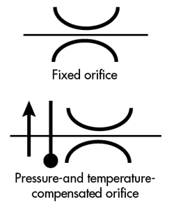

Figure 1 shows symbols for a simple fixed orifice (a rudimentary component that restricts flow) and a fixed orifice with pressure and temperature compensation. A fixed orifice can be a simple restriction in a line or a factory-preset control with pressure compensation and a bypass. Their low cost and tamper-proof operation are two main reasons for using fixed orifices.
1. Shown are standard symbols for flow-control valves: a fixed orifice, top, and a fixed orifice with pressure and temperature compensation.

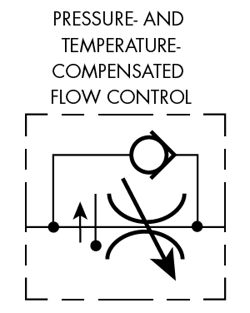

Not surprisingly, nomenclature sometimes confuses this issue in identifying flow-control hardware. Normally, the term flow control refers to an adjustable needle valve with an integral bypass (Fig. 3). This type of flow control meters flow in one direction and allows free flow in the opposite direction. However, some companies identify the valve in Fig. 3 as a throttle valve because it does not provide pressure compensation. The needle valve represented in Fig. 4 does provide pressure- and temperature-compensated flow in one direction.
When a hydraulic actuator needs accurate speed control, use a pressure-compensated flow control. Otherwise, system pressure fluctuations or load changes will affect actuator velocity. Regardless of the cause of the pressure differences, flow across the orifice will change unless the flow control is pressure compensated. However, pressure-compensated valves cost several times that of the non-compensated variety, so use them only when very accurate speed control is needed.

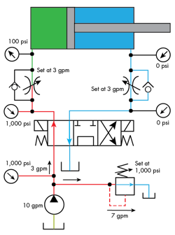

Figure 5 shows a meter-in flow control with the pressures and flows indicated while the cylinder is extending. Notice that a bypass check valve forces fluid through an adjustable orifice just before it enters the cap end of the cylinder. With a meter-in circuit, fluid enters the actuator at a controlled rate. If the actuator has a resistive load, movement will be smooth and steady because hydraulic fluid can be considered incompressible in most cases.

A meter-in flow control will not work if the actuator has an overrunning load (the load pulls on the piston rod). When the directional valve shifts, a strong tensile load on the cylinder rod makes it extend. Because fluid cannot enter the cylinder’s cap end fast enough, a partial vacuum void forms in the line. The cylinder then free falls, regardless of the setting of the meter-in flow adjustment. The pump will continue to supply metered fluid to the cap end of the cylinder and will eventually fill the void. The cylinder can produce full force after the void has been filled.

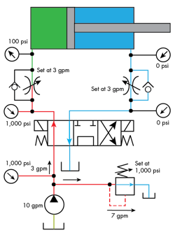

Meter-out flow controls restrict fluid leaving the cylinder to retard the cylinder’s movement. This type of flow-control circuit works for any type of load—and it works best with air-operated devices.

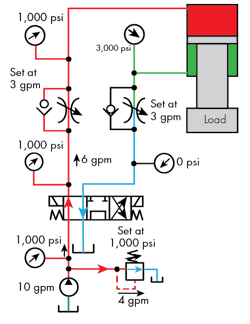

Figure 6 shows a meter-out circuit with the cylinder extending. Fluid in the cap end is at system pressure, and the relief valve dumps excess pump flow to tank. Pressure at the rod end of the cylinder will be at system pressure or higher according to the rod size and force required to move the load. The action of meter-out flow controls is smooth and steady for hydraulic and pneumatic circuits.

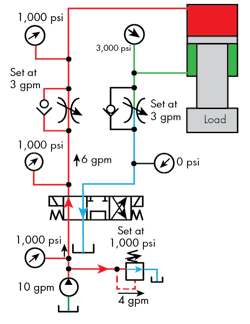

Figure 7 represents a meter-out flow control regulating the load on a down-acting vertical cylinder. This over-running load moves steadily because the circuit restricts flow leaving the cylinder. The meter-out circuit keeps the load from running away but, depending on the load and the rod size, excessive pressure could exist in the cylinder’s rod end. Notice in this case that the rod-end pressure is 3,000 psi when extending. This is because the rod is oversized (2:1) and the load is heavy. At a relief valve setting of 3,000 psi, this rod-end pressure could be as high as 7,000 psi.

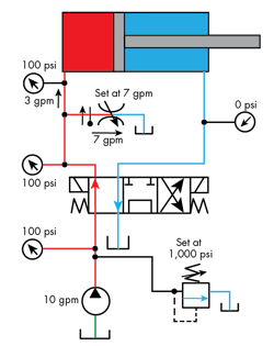

A bleed-off flow-control circuit extending a cylinder is represented in Fig. 8. Bleed-off flow controls often are referred to as bypass flow controls. This type of flow control circuit bleeds off excess fluid to tank. A bleed-off flow control works best in hydraulic circuits using fixed-displacement pumps. However, a bleed-off circuit only works with multiple actuators if they operate one at a time.
6. Meter-out circuits provide smooth motion for both resistive and over-running loads in hydraulics and in pneumatic systems. Their versatility has led to many instructors to advise, “When in doubt, meter out.”
When oil passes to tank through a pressure-compensated flow control, cylinder movement will slow while system pressure rises only high enough to move the load. Although this arrangement wastes energy, the amount is minimal. For example, the cylinder in Fig. 8 extends at 3 gpm while 7 gpm passes to tank through the pressure-compensated needle valve. Because the resistance of the cylinder and load is only 100 psi, the wasted energy is low. In most cases, use a bleed-off circuit where only a small amount of fluid goes to tank in fine-tuning actuator speed.
The 3 gpm flowing to the cylinder generates no heat because it is doing useful work. The 7 gpm going to tank at a 100-psi pressure drop is the only wasted energy—but only 1,038 btu in this case. If the cylinder engaged a load requiring 300 psi, then the whole system would climb to 300 psi. Energy loss would increase but still would be much less than in a meter-in or meter-out circuit.
