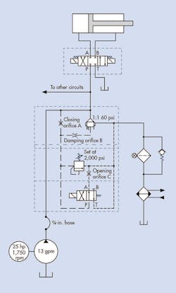

What circuit issue caused a cargo ship's hydraulic power unit (HPU) to delay opening and closing hatch doors when pressing the solenoid button?
A cargo ship has a hydraulic power unit (HPU) that opens and closes several hatch doors on grain-storage areas. The accompanying schematic shows a circuit for one of eight cylinders and valves located close to the doors, with the HPU on a lower deck. The HPU is located midway between two sets of four. The pressure and return lines run approximately 200 ft. in each direction.
Every time operators wanted to open or close a door, it would take almost a minute holding the solenoid button before the pressure would reach a pressure that would start moving the cylinders. Once started, they moved as expected. However, releasing the button and pushing it again caused a one-minute delay before anything would move again.
The electrical system was simple. Pressing a button for any solenoid would also energize the solenoid on the unloading valve located on top of the main relief.
Bleeding air from the system did slightly reduce the delay. However, can you tell the main cause of the problem from the schematic?

Mill Removal Circuit Doesn’t Move for Large Rolls
Regenerative circuits are used to increase the speed of a cylinder by routing fluid exiting the rod end back into the cap end. However, if the circuit remains in the regenerative mode when encountering a heavy load, the cylinder will be unable to apply full force unless rod-end fluid vents to tank.
The 0.020-in. orifice branching off the rod plumbing in was used to accomplish this bleed-down. They found this orifice plugged and once it was cleaned, the system worked well.
