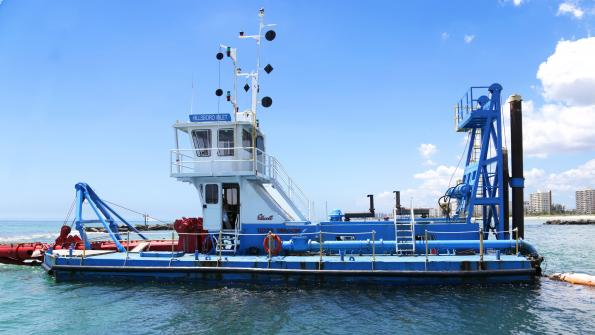

That’s the situation faced every day by the crew of the offshore dredge at Hillsboro Inlet, on the east coast of Florida. Captain Woodworth “Woody” Draughon—who first started with steam-powered bucket dredges in the Panama Canal—and Assistant Captain Scott Evans have been working together running the year-round dredging operation at Hillsboro Inlet for more than 20 years. This operation keeps the pass free of sand, both for boating traffic and drainage, to prevent inland flooding during storms.
Ellicott Dredges, Baltimore, is the largest dredge manufacturer in the U.S. and has been building dredges since 1885. It supplied all the dredges used in the original construction of the Panama Canal. Focused on cutter suction dredges, its largest dredge has an output of 2,000 cubic yards per hour. Working on board the custom 1170-S Ellicott Dredge, the crew stays busy running the dredging operation and maintaining the equipment in a hot, salty, humid environment. The dredge includes two diesel engines—the main Caterpillar C-27 and an auxiliary Caterpillar C-9—that power a 9,000-gpm pump pushing out 400 cubic yards of sand per hour from the dredge down across the bottom of the pass and out onto a nearby beach to replenish the shoreline.

With the cutter head at the bow of the dredge, the control room two stories above the deck, and the engine room at the other end of the dredge and down below the deck, the process of fine-tuning the valve includes a lot of back and forth, up and down ladders. The captain has to drag a handheld programmer and cables down into the cramped, dark engine room to the winch control hydraulics, connect physically to the amplifier, step through the settings, then climb back out and up to the control room to operate the controls and view the results of those settings. From start to finish, fine tuning the valve to optimize the winch performance can take hours.

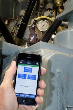

Sun’s new Bluetooth Embedded Amplifier, the industry’s first commercially available Bluetooth-configurable product, provides a compact, factory-integrated coil and connector combination for use with Sun’s proportional solenoid valves. And yes, there’s an app for that. Users configure the embedded amplifier wirelessly using Sun’s AmpSet Blue app on their iOS and Android mobile devices for quick, easy, reliable wireless calibration.
AmpSet Blue allows users to locate and “pair” with the selected amplifier using their smart device and to adjust all parameters of the proportional controller through several simple screens. This eliminates the need to carry a separate programmer or expensive laptop with special cables. With the app, users can name each device and save, store, recall, and share settings for future use. For security, the settings of the device can be password protected to prevent tampering by unauthorized individuals.

Draughon walked through the various settings available on the app, then went to the engine room to confirm connection with the amplifier. Every time you open the AmpSet Blue app, it initiates a Bluetooth scan, looking for any Sun Bluetooth amplifiers that are powered up and within range. When the captain started the app up, it identified the new amplifier. Once he clicked on the detected amplifier, the app paired with the amplifier and the status light blinked blue, indicating that connection was made and configuration could begin.

A big challenge with dialing in the settings for this application lies in the deadband tuning. In the control room, Evans needed to rotate the potentiometer controlling speed almost half a turn before the dredge arm began to move at all. On the deck, in sight of the arm and in communication with Evans, Draughon was able to raise the minimum output. This allowed higher current from the coil at a lower command voltage and caused the boom to move just after they started to turn the potentiometer. Because of the quick configuration and feedback, the crew was able to set the valve more precisely to their liking, more easily, and in less time.
