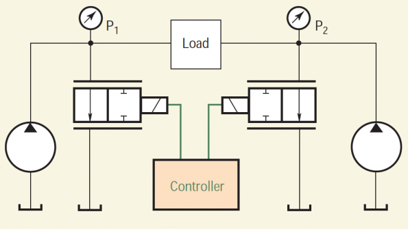

Differential pressure can be controlled using fixed displacement pumps and electrohydraulic proportional or servovalves. However, two pumps and two valves are required, as shown in Figure 2. The function is quite similar to the gauge pressure controller just discussed, and the sizing issues are very similar.
Figure 2 — The three-way and fixed-displacement pump provide positive pressure rise and fall as well as positive load throughflow cutoff.
Differential pressure control does not necessarily control the gauge pressures on the two sides of the load. For example, differential pressure can be completely controlled with only one of the valves being variable. By changing only one of the valves, pressure on that side of the circuit could rise from its minimum (which is determined by the pump flow and the full open valve coefficient on that side) to any safe upper limit. Meanwhile, pressure on the opposite side would remain essentially constant at some mid-range value.
The load differential pressure can be positive or negative. It should be evident that pressure on the opposite side can also be made to rise to any safe limit while the other side remains constant. Thus, when both valves are continuously variable, the differential pressure can be controlled.
What about the gauge pressures on each side? In the example at hand, one side of the load is always at minimum while the other rises. Therefore, the maximum gauge pressure on either side is simply the minimum pressure plus the maximum desired target differential pressure on the respective side. The two gauge pressures are under a kind of control in that they are limited, even though that is not the specific aims of the feedback controller.
Coordinating valve opening and closing
A coordination that takes place between the two valves is more subtle. Coordination is accomplished through the controller: When one valve is being modulated electronically, the other valve is forced into its full open state. In other words, the controller — either by analog design or with software in a digital controller — would have to cause the two valves to behave in that prescribed manner. The specific variations in the gauge pressures depend on the specific logic that coordinates the two lands.
Other methods exist for coordinating the opening and closing of the two valve lands. However, before exploring them, note that the advantage of electronic coordination is the ease with which the relative timing in opening and closing can be adjusted.
For example, bias currents can be provided to put each land in its mid position. Command voltage, then, would create varying spool positions to control motor (load) differential pressure. This control strategy will raise the gain of the valve, thereby increasing sensitivity. Again, the gauge pressures depend on the specific method and amount of biasing and varying the two lands.

Figure 3 — Differential pressure can be controlled with two fixed pumps and two two-way proportional valves synchronized through a controller.
Purely mechanical means can be used to perform the coordination function and its effects upon the two gauge pressures. Consider that a single valve controls differential pressure, as illustrated in Figure 3. The coordination is accomplished by the two variable coefficients mounted on a single spool so that as one goes up, the other goes down. In this configuration, the gauge pressure on either side will be a fairly complex function of the specific orifice geometry variation designed into the valve lands, the load resistance, and the output flows of the two individual fixeddisplacement pumps.
The advantage of this circuit are that differential pressure — and its algebraic sign — is controlled. Also, it uses fixed-displacement pumps. Lastly, there is only one proportional valve, which must cross over center. However, the valve is not zero lapped. In fact, the valve is more like an open-center valve than a closed-center one, but it has only two variable lands. This kind of valve has been referred to as a reverse three-way valve, or a flow combiner valve, which is a kind of flow divider valve. Whatever it is called, it can make a very good differential pressure control system.
