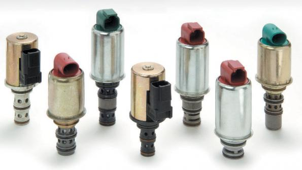

Functionality
Cartridge valve manufacturers provide a wide variety of valve functions, allowing circuit designers to find almost any hydraulic control function in cartridge form. Typical functions provided by cartridge valves today include:
  • check valves
  • pilot-operated check valves (single-and dual-pilot operated)
  • relief valves (both direct and pilot operated)
  • sequence valves c pressure-reducing valves c flow control valves (pressureand non-pressure-compensated)
  • load-control valves c counterbalance valves c flow-dividing/combining valves (fixed, priority, proportional divider)
  • manual directional valves c solenoid valves in 2- or 3-way poppet or spool type, and 4-way, 2- or 3-position versions
  • electro-proportional directional, flow, and pressure controls, and
  • specialty valves: shuttle valves, velocity fuses, and composite material valves.
Innovations in cartridge valves have taken many paths in terms of functionality, size, and form. Manufacturers are incorporating multiple functionalities into single valves mixing flow, pressure, and directional controls to reduce the number of cartridges required to perform a given task. Additionally, internal valve leakage issues are being addressed with the use of engineered composites and other exotic materials.
Valves continue to grow both smaller and larger, as HICs are used to tackle lower flow applications and main system controls. Cartridge valves are being used in applications once thought to be purely the domain of sectional spool valves with capabilities beyond 50 gpm within reach. Miniaturization of valves for use in compact hydraulic packages has created valve solutions that are the thickness of a pencil and less than 1-in. long.
Pressure capabilities of cartridge valves continue to expand, as well. Demanding applications in the mobile market are pushing working pressures to 6000 psi (415 bar) with intermittent demands of up to 7200 psi (496 bar) in some cases. Cartridge valves capable of operating in these conditions and beyond are being developed and produced in many styles.
Advancements in cartridge design also come from practical areas, as machine users place equipment in more demanding environments. Some of the most important gains in machine reliability have come from improved resistance to moisture in electrical solenoids. Users — particularly in the growing rental markets — frequently wash down equipment with high pressure washers. Solenoids with molded connectors and weather resistant molding techniques offer IP69 ratings for maximum protection.
