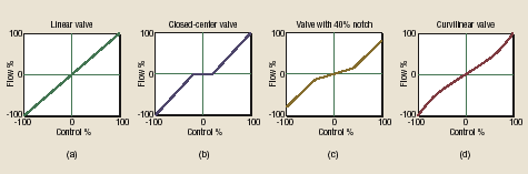

Figure 1. Different operating characteristics are shown for a linear valve (a), a closed center valve (b), a 40% notch valve (c), and a curvilinear valve (d).

Proportional valves are so named because the valve spool shifts in proportion to the control signal driving the valve. However, flow is not necessarily proportional. Proportional valves may have many different types of spools — and making the correct spool choice is critical for maximizing system performance.
For position and pressure/force control, a proportional servo-quality or axis-cut spool should be selected. These spools provide flow proportional to the control signal, providing that pressure drop across the valve stays constant. These valves have a constant gain because the response is linear, Figure 1(a).
Closed-center spools
There are many forms of nonlinear spools with many names. The most common is the overlapped or closed-center spool that appears to have a deadband, or zero gain, region because the valve ports do not allow flow while the control signal is small, Figure 1(b). This may reduce leakage and make it easier to keep a system stopped while in manual control, but it also makes these valves poor choices for position or pressure control applications, because the spool must be shifted very quickly across center to provide fine pressure or position control.
The larger the deadband, the longer it takes to shift the spool across it. During these few milliseconds, there is essentially no flow response from the valve — resulting in no change in position and pressure input to the motion controller. This discontinuity in feedback reduces the ability for a motion controller to maintain precise positions or pressures. Closed-center valves should only be used on applications where the spool does not need to shift quickly across the deadband, i.e., where motion doesn't change direction rapidly or often. Speed control applications like conveyors are good examples of these applications.
Dual-or variable-gain spools
Other spools have flow gains that vary with the control signal. These valves usually have low flow gains while the control signal is close to zero and higher flow gains as the signal approaches ±100%. Notch or dual-gain valves have distinct low and high gain regions, Figure 1(c), while curvilinear valves have continuously varying gains, Figure 1(d). For manual systems, this results in fine control at slow speeds while providing a lot of flow for high speeds.
Although not a problem with manual or open-loop control, the non-linear valve makes the whole system non-linear — so closed-loop control is difficult. The closed-loop controller is required to change its gains on-the-fly as the valve shifts between high-and low-gain regions. In theory, this valve linearization (compensation for the varying gains as a function of the control signal) can be done within the motion controller, using a look up table or a specific formula.
The need for matching the characteristics of the specific valve limits the usefulness of this approach. Notch spools can work well in machine applications where closedloop control is only required at slow speeds. Open-loop or manual control can be used at higher speeds, where the valve is in the high gain region. This way, the closed-loop controller does not need to change its gains on-the-fly as the valve shifts between high and low gain regions. However, for most position or pressure control applications, it is better to avoid notch or curvilinear spools.
