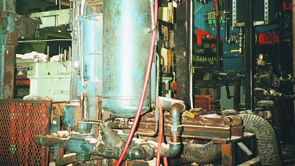

Typical of core blowers, this was a pneumatic machine with an air-over-hydraulic drive system to close its clamp and an intensifier to create the required 1100-psi hydraulic clamping pressure. The machine had two 7-in. bore, 30-in. stroke, ram-type clamp cylinders. The design velocity specified that the clamp cylinders should extend 18 in. within 2 sec, which required a large amount of compressed air during this part of the cycle.
Operating problems that the manufacturer was having seemed related to the fact that compressed air demand at the Tennessee plant had grown to the point where it often exceeded the facility’s capacity. The resulting pressure fluctuations were limiting the cylinder speeds that the air/oil system could produce. Additionally, because of the dirty foundry environment, the intensifier was a high maintenance item, and the original circuit was a plumbing nightmare for the maintenance department.
