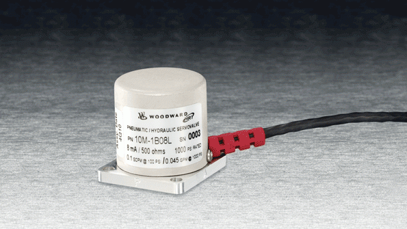

Miniature servovalve
Model 10M is single-stage, dual-nozzle, flapper-type servovalve that controls 2-, 3-, or 4-way flow or pressure in hydraulic or pneumatic systems at
pressures as high as 1000 psi. Size: <1.5 in.3, <2.5 oz. Bipolar electrical command signals translate to differential flow or pressure outputs. Dynamic response is >400 Hz. Has flexible, 4-lead, strain-relieved cable, parallel wired. Mounts on standard ARP-490 Type 1B, 0.48-in. circle.
