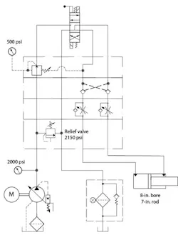

A new hydraulic system for operating large blast doors was installed in a secure government facility. The doors protect the facility’s entrance and normally require a relatively low pressure — just 500 psi maximum — to operate. However, if an emergency occurs, such as an earthquake, the doors must be able to operate at a much higher pressure — up to 2000 psi — to overcome resistive forces from any debris that may be obstructing their path. An engine driven generator provides backup electrical power when the doors operate in their emergency mode. The system’s directional valve is normally actuated electrically. But designers wanted the option of shifting the valve manually and increasing the cylinder force, if necessary. Operators can increase the pressure by adjusting the pressure reducing valve from 500 psi up to a value that will allow the door to push the debris out of the way.
The power unit assembly was located about 50 ft from the door-mounted cylinder. High-pressure hoses — which were 65 ft long and 1-in. — connected the cylinder to the power unit. They needed flexibility in case there was movement of the stone facility during an emergency.
The circuit shown is fairly simple and worked well during start-up. However, if the power unit was left idling with the directional valve in the center position, the door and cylinder would not move when the directional valve was shifted.
The installation crew was made up of pipe fitters and mechanical engineers. They replaced the entire valve stack, down to the sub-plate, and cylinder with spare parts they had on hand, but the system would still lock up if the power unit was left idling.
They observed that both cylinder hoses seemed to be hard, as if they had pressure on them. They also noticed that the reduced pressure gauge reading would slowly build up to pump compensator setting.
Based on the information given, what is the source of the problem?
