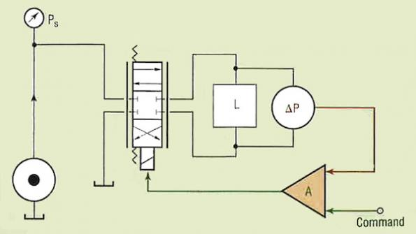

Figure 1. The constant-pressure source with a four-way valve can control either gauge pressure or differential pressure. Click on image for larger view.
It is probably safe to say that the four-way directional control valve will always work in the valve-controlled pressure control system. It is shown in a simplified schematic in Figure 1. The first advantage of the four-way configuration is that it can control not only gauge pressure, but differential pressure, as well. In fact, if differential pressure needs to be controlled, which might be the strategy used to regulate torque from a hydraulic motor or rotary actuator, then a four-way valve is required.

If differential pressure is controlled, and the algebraic sign of the pressure must be reversed, then the valve must always cross over center, even with through flow. This makes the degree of valve overlap critical. In such situations, a zero lapped valve is normally called for. The circuit configuration is shown in Figure 1.
Three possible through-flow paths exist for differential pressure control. The first is from one valve port to tank, the second is from one side of the load to the other, and the third is from the opposite valve port to tank. This is precisely the situation that exists when the load is a conventional, continuous rotation hydraulic motor, Figure 3. The valve must account for internal leakages and compressibility flow and simultaneously maintain a targeted differential pressure.
