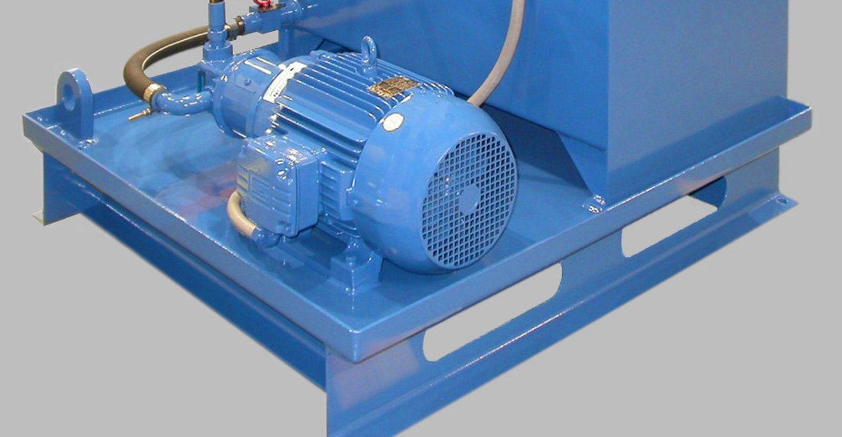

In this column, I have a third, similar quandary for you to ponder: the installation of pump intake isolation valves. As background to this issue, at a recent hydraulic maintenance workshop I presented, I was asked for my opinion on isolation valves on pump intake lines, and whether a more expensive ball valve is mandatory, vis-à-vis the generally cheaper butterfly type.
At the root of this question is the negative effect of turbulence in the pump intake line. The argument for using a ball valve as an intake line isolation valve is that, when it’s open, the full bore of the valve is available for oil flow. So if you have a 2-in. ball valve installed in a 2-in. intake line, when the valve is open, from the oil’s point of view at least, it’s as if it wasn’t there at all.
A butterfly valve on the other hand, is not full bore. Even when fully open, the butterfly remains in the bore and presents a partial restriction which is irregular in shape. This causes turbulence, which can result in dissolved air coming out of solution in the intake line. If this happens, these air bubbles will collapse when exposed to pressure at the pump outlet. In other words, a butterfly valve may cause gaseous cavitation.
So if an intake line isolation valve is installed, which is best: ball or butterfly type? Well, like a lot of issues in hydraulics, it depends. In a perfect world I would always chose a ball valve ahead of a butterfly valve. And for intake line diameters up to 3 in. there is virtually no cost penalty involved in doing so.
But when you get into 4-, 6-, and 8-in. diameters, ball valves are very expensive in comparison to their butterfly counterparts. And they take up a lot more space—particularly in overall length. So, in a mobile application for example, not only may the cost of a large diameter ball valve be prohibitive—there may not even be enough space between the tank outlet and the pump inlet to install it!
But as you may have guessed from my introduction to this article, there is third alternative. Don’t install an intake line isolation valve at all. Intake line isolation valves are like suction strainers, in so far as many people wrongly believe they are essential. When in reality, but for a few exceptions, they are not.

I know, there are exceptions. If there’s more than one pump sucking from the same tank. Or it’s just not practical to pump, say, 3,000 gal of oil out of the tank. But even in these cases, pulling a vacuum on the reservoir headspace will still work. With that said, I am willing to concede intake-line isolation valves are sometimes a necessity. In which case it’s wise to make sure they’ve got proximity switches to prevent the pump(s) from being started when the valve(s) are closed!
But despite the odd exception, my preferred approach to pump intake line isolation is: fit neither ball valve nor butterfly valve if you can get away with it. If you have to have one, use a ball valve if cost or space aren’t an issue. But if either of these things are a problem, then a butterfly valve is the only choice left.
