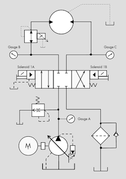

A land based oil-drilling rig used a large hydraulic unit (HPU) and motor to power its top drive unit for the drill pipe. The pump-motor and valve manifold was mounted on top of a 200-gal reservoir.
The crew was having problems with the pump losing its prime every time they shut down for more than 15 to 30 min. The hydraulic technician could not find where air was getting into the pump, and one of the roughnecks told him that all it needed was a flapper-type check valve installed in the intake line. The worker was accustomed to mud system pumps that transfer mud from one tank to another, and those use flapper checks on the intake of the pumps.
The technician thought this would be a good fix, so he installed a flapper-type check valve in the pump’s suction line. He started the HPU and bled air from the system until it quieted down. The pump then compensated at 3,200 psi. However, when the technician shut the HPU unit down, to his surprise, the brass flapper check blew apart.
Why wouldn’t the hydraulic pump hold its prime, and why did the flapper check blow out?
