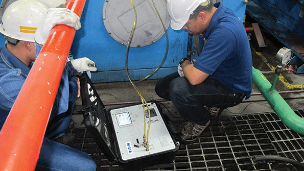

The best way to maintain a hydraulic system is to make fluid change/filtration decisions based on actual fluid condition, rather than time-in-service or other arbitrary measures. Using a “laboratory-in a-suitcase,” such as the OCM 01 Condition Monitoring System from Eaton’s Internormen Product Line, in the field helps facilitate that process.
Portable contamination assessment instruments, such as this OCM 01 condition monitoring system, provide instant indication of a hydraulic system’s fluid cleanliness.
It’s flexible enough to work in either suction or pressure mode, and can handle traditional bottle samples. The compact machine can measure:
