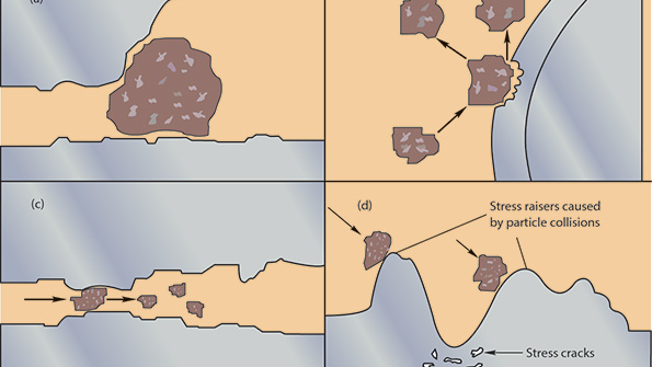

Aside from human interference, the most common source of system impairment is fluid contamination. Contamination can exist as solid particles, water, air, or reactive chemicals, all of which impair fluid functions in one way or another.
As the figure below shows, three-body mechanical interactions can result in interference (a). Two-body wear is a common occurrence in hydraulic components (b). Hard particles can create three-body wear to generate more particles (c). In addition, particle effects can trigger surface wear (d).

In broad terms, contaminant interference manifests itself as either mechanical or chemical interaction with components, fluid, or fluid additives. Mechanical interactions range from blockage of passages by hard or soft solid particles, to wear between particles and component surfaces (see the figure). Chemical reactions include formation of rust or other oxidation, conversion of the fluid into unwanted compounds, depletion of additives (sometimes involving harmful byproducts), and production of biochemicals by microbes in the fluid.
Any of these interactions will be harmful. Without preventive measures and fluid conditioning, their negative effects can escalate to the point of component failure. One of the most common failure modes is excessive wear due to loss of lubrication.
