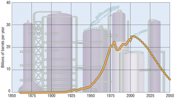

World oil production is currently peaking, but it is forecast to drastically diminish. Click on image for larger view.
In the 1950s, the big oil companies made efforts to establish statistical models. They wanted to forecast the total production of an oil field, or of a whole country, including the reserves still to be discovered. This led to more complete mathematical models that can provide us with information about the reach of world reserves. You can deduce from the curve shown in the figure below that the maximum of world oil production is just about upon us. Further serving the steadily growing demand will be possible only at considerably higher prices in the middle and long term.
