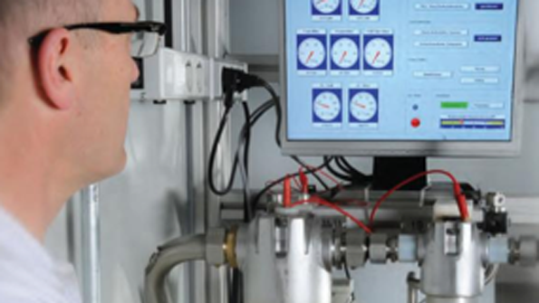

This test bench at HYDAC was designed and built specifically for analyzing the electrostatic behavior of hydraulic filters. It proved essential in the development of Stat-Free elements, which combat static buildup and dissipate charges that do occur.
Solution — Using a custom designed test bench, HYDAC Filtertechnik engineers analyzed the electrostatic behavior of hydraulic filters in critical oils. The culmination of their work is HYDAC’s Stat-Free filter element series, which combats the problem of electrostatic discharge. The elements are designed to be discharge-capable and are made of media combinations that minimize the charge generation of the filter and the oil. Stat-Free elements not only eliminate the consequences of electrostatic charging, but the cause itself.
