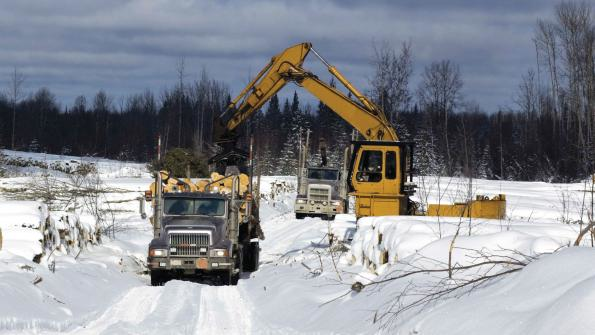

Cold temperatures can thicken hydraulic fluid, which can damage pumps from cavitation. The alternative is to wait for fluid to warm up, which robs productivity by keeping machines idle. Hydraulic fluid warmers, below, left, solve the problem by using engine heat to warm hydraulic fluid.
