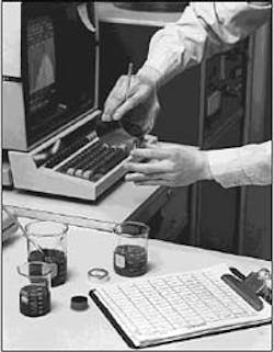

Initial laboratory tests determine if the hydraulic oil can be reclaimed. From the sample, customers receive a written laboratory analysis, and a cost estimate for reclamation.

Testing hydraulic fluids
The main reason to test hydraulic fluid is to find out if it can continue to be used in the system. Tests are conducted to see how much dirt is in the oil; the concentration and type of contamination (iron, copper); and how much component wear. For instance, tests can determine the amount of iron and copper in the oil. High iron generally indicates pump wear. High copper content is a sign of bushing wear. Excessive component wear can be an indication of the wrong type or grade of fluid being used.
Tests are also run on new or reclaimed oil to see if the quality does indeed meet set specifications. Finally, tests also indicate which reclaiming method would be best to use on the fluid.
There are several tests that allow us to examine the cleanliness of the oil. One of these is not just by looking at the oil. Even if it looks brand new, there could be high contamination levels. You cannot determine the contamination level of hydraulic fluids simply by looking at them.
Acid (neutralization) number tests measure lubricant breakdown or additive content. If results from this test are poor, simple filtration or centrifuging will not correct the problem. Chemical treatment or additive changes are required.
Metal analysis confirms additive levels in many anti-wear and extreme pressure lubricants. Trace metals track wear or contamination. However, metal analysis can't determine the additive's condition and more testing is necessary.
One of the more common testing procedures is the particle count or millipore test, which determines the degree of cleanliness. It 's also used to see if the cleaning method chosen worked. A major advantage of millipore testing is that analysis of the millipore patch can aid in identifying the type of contaminant.
Water content tests should be able to test for amounts down to a tenth of a percent as higher amounts can cause problems; flash point tests determine solvent contamination; and RBOT tests tell users the remaining R&O additive content and life remaining in the lubricant base.
