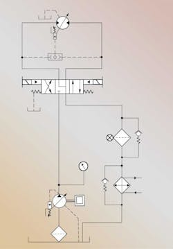

An automotive company built an assembly plant on land that had a limestone base. Research found that if the limestone was removed, crushed and re-laid, the plant stability and harmonics would be improved to a point that would offset the cost of crushing the limestone.

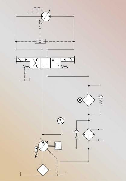

They used a large rock crusher that had a fairly simple hydraulic circuit, as pictured. Two Caterpillar front end loaders would dump large chunks of broken limestone into a chute from either side of the rock crusher. A mechanical vibrator would move the limestone down to a large rotating drum with 50 to 60 swinging hammers that would pulverize the limestone into stones no larger than a tennis ball. The crushed stone would then be laid back into the ground to build the base for the new plant.
The problem they were experiencing was overheating of the hydraulic oil, which caused the over-temperature sensor to shut the unit down. It could be up to an hour before the system would cool down and reset the sensor.
We were asked to investigate and fix the problem. The customer was sure it needed a larger fan-cooled heat exchanger. We watched the operation for a couple of hours and noticed that the overheating shut down occurred shortly after the crusher drum was stopped or allowed to free wheel for more than 20 to 30 minutes.
Any idea what could have been causing the problem? Can you think of a simple fix?
