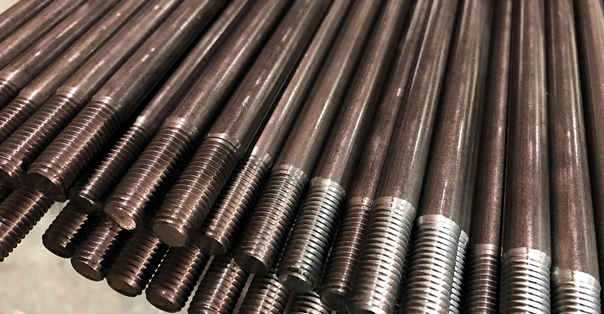

A shock absorber manufacturer has a standalone hydraulic system that feeds round rod stock from a coil into a machine that cuts the continuous rod to length, finishes it to the diameter needed, threads both ends, and sends finished pieces to a heat-treating furnace.
The speed and pressure on the hydraulic feed system varies with the rod diameter and the size of the coils. Operators manually feed the rod into entry unit rolls driven by the hydraulic system represented in the schematic.
The speed and preset are dictated by the rod diameter, whereas the relief valve pressure is set approximately 150 psi above the pressure required to pull (unwind) the coiled rod stock. A problem developed with the system pressure oscillating as much as 200 psi. The diameter of the control orifice—located between the shuttle valve and relief valve—was .042 in. The system worked for several years, but after the pressure oscillations began occurring, technicians replaced the main relief valve with the same brand and model number. However, the problem persisted.
Any idea as to what is causing the problem and why this would happen?
