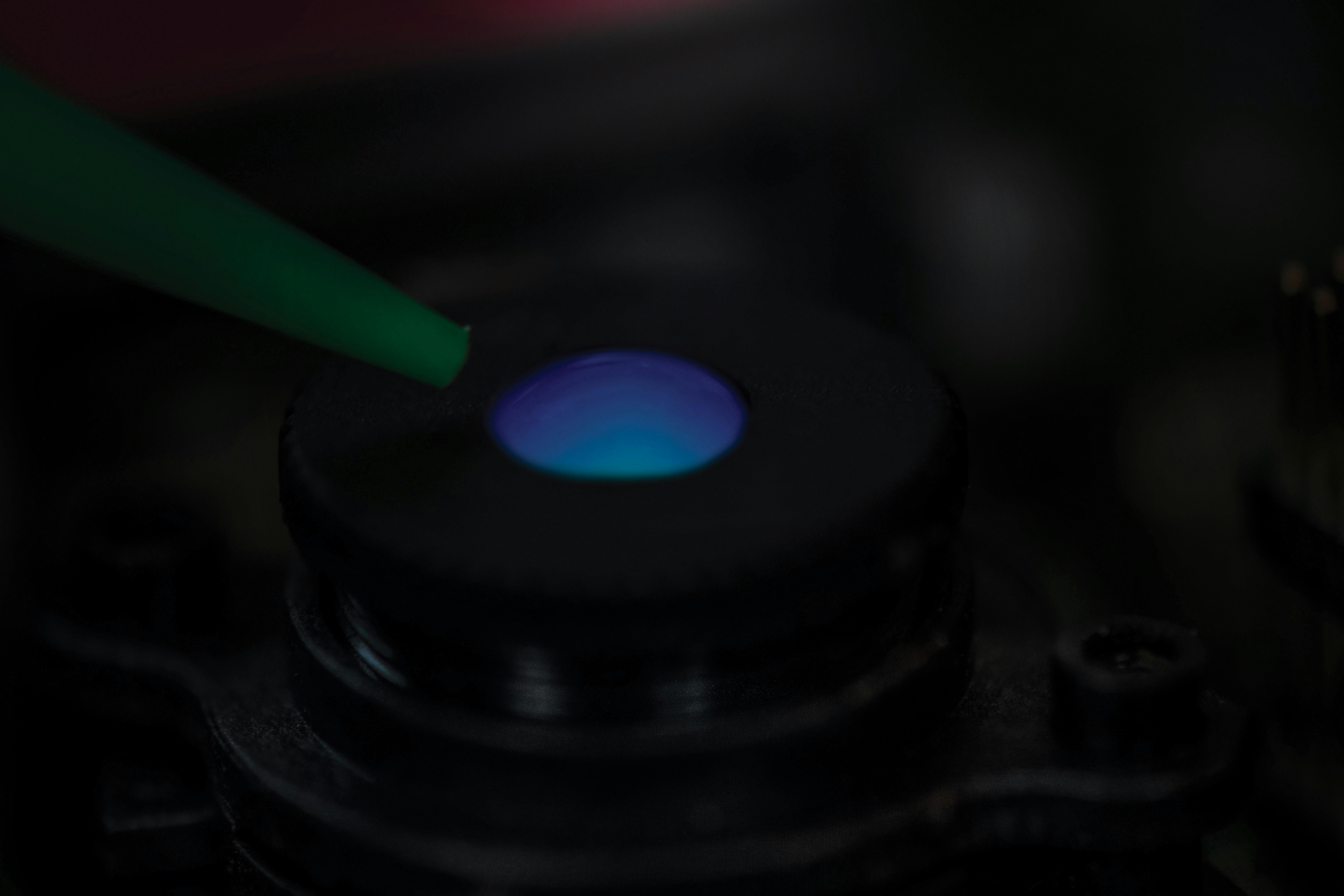

Master Bond UV16Med-FD is a one part, low viscosity, epoxy based UV curable system containing a fluorescent dye for identification. This feature enables visual inspection with a UV black light to detect voids or overflow and confirm product placement. Engineered for bonding, sealing, coating, and spin coating across a variety of medical device applications, this system passes ISO 10993-5 standards for non-cytotoxicity.
UV16Med-FD resists acids, bases, solvents, and sterilants including ethylene oxide and glutaraldehyde. It also withstands repeated autoclaving. The cured material is optically clear, with a refractive index of 1.511 at 75°F. Tensile strength measures 7,000–8,000 psi, and tensile modulus ranges from 250,000–300,000 psi at room temperature. A low viscosity of 250–500 cps at 75°F makes the material suitable for application by syringe or spin coating. It adheres to substrates including plastics, glass, ceramics, and metals.
UV16Med-FD is a cationic system that contains no solvents or diluents and is not oxygen inhibited. Exposure to UV light at 320–365 nm, with a minimum intensity of 20–40 mW/cm2, initiates the cure. The cure rate depends on light intensity, distance from the source, and section thickness. Post curing at 125°C for 30 minutes brings the glass transition temperature to 130–135°C, which improves autoclave resistance. The service temperature range spans -80°F to +400°F (-62°C to +204°C). UV16Med-FD is available in 1/2 pint, pint, quart, gallon, and 5 gallon containers, as well as EFD® syringes compatible with many automated dispensers.
