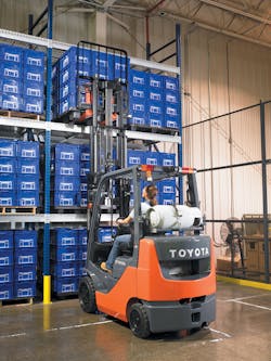

The higher and faster that forklift operators go to meet productivity goals, the more important stability becomes. An electrohydraulic system helps keep those operators vertical and their loads intact.
Equipment designers and users love what the power and control of hydraulics can do for productivity. Yet, when a machine requires a human operator to achieve that, productivity and safety must go hand in hand. Whether dealing with the uneven terrain of construction sites and agricultural fields, or keeping a forklift and its load upright on a relatively level warehouse floor, the safety of workers depends on loaded forklifts staying stable and upright in all types of environments. Toyota’s System of Active Stability (SAS) was designed to directly improve vehicle stability by automatically stabilizing loads during high lifting and reducing the possibility of the forklift and its load tipping over as it turns.

It’s not unusual for today’s warehouses to require placing and retrieving loads to heights of 20 ft. or more. An improper move by an operator could cause a load to fall off the forks. The challenge is allowing the forklift to operate quickly for high productivity, yet remain safe when working at high elevations. Toyota’s SAS feature achieves both by limiting mast tilt and tilt speed once the forks are higher than a pre-determined height established by placement of a limit switch and a load sensor.
When the operator raises the mast higher than the limit switch, it signals the ECU and the ECU looks at the load sensor. The ECU determines the weight, and then energizes a flow-control system that limits tilt speed to a preset value based upon those values. The ECU also limits stroke of the tilt cylinders to keep the operator from tilting the mast too far forward, thus preventing load spills or tipping the forklift forward.
