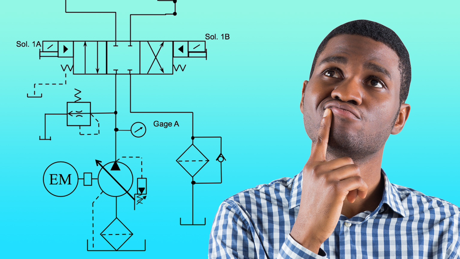

A foundry casts 8-cylinder engine blocks then moves them through the machining department. After milling and drilling is complete, the blocks get transferred to a large automated washing, cleaning, and dryer machine.
The foundry had replaced an old hydraulic power unit with a new one when it overhauled and upgraded the washer. The power unit company built, installed, and commissioned the new unit. It had a 45-gpm pressure-compensated piston pump rated at 1,000 psi with the same pilot-operated directional valve used on the older unit. The pump/motor was mounted on top of the reservoir, so an air bleed valve was added to help prime the pump. The original unit had an older directional valve with air gap solenoid; the replacement one had the newer wet armature solenoids. Everything was mounted on the reservoir in a neat compact arrangement.
The new pump failed after six weeks of running and was send back to the manufacturer for servicing under the warranty. The supplier denied the claim, saying the pump failed due to over pressurization. The original gauge was replaced, and a new pump installed and adjusted to 1,000 psi. Eight weeks later the pump failed again.
Any idea what the problem could be?
