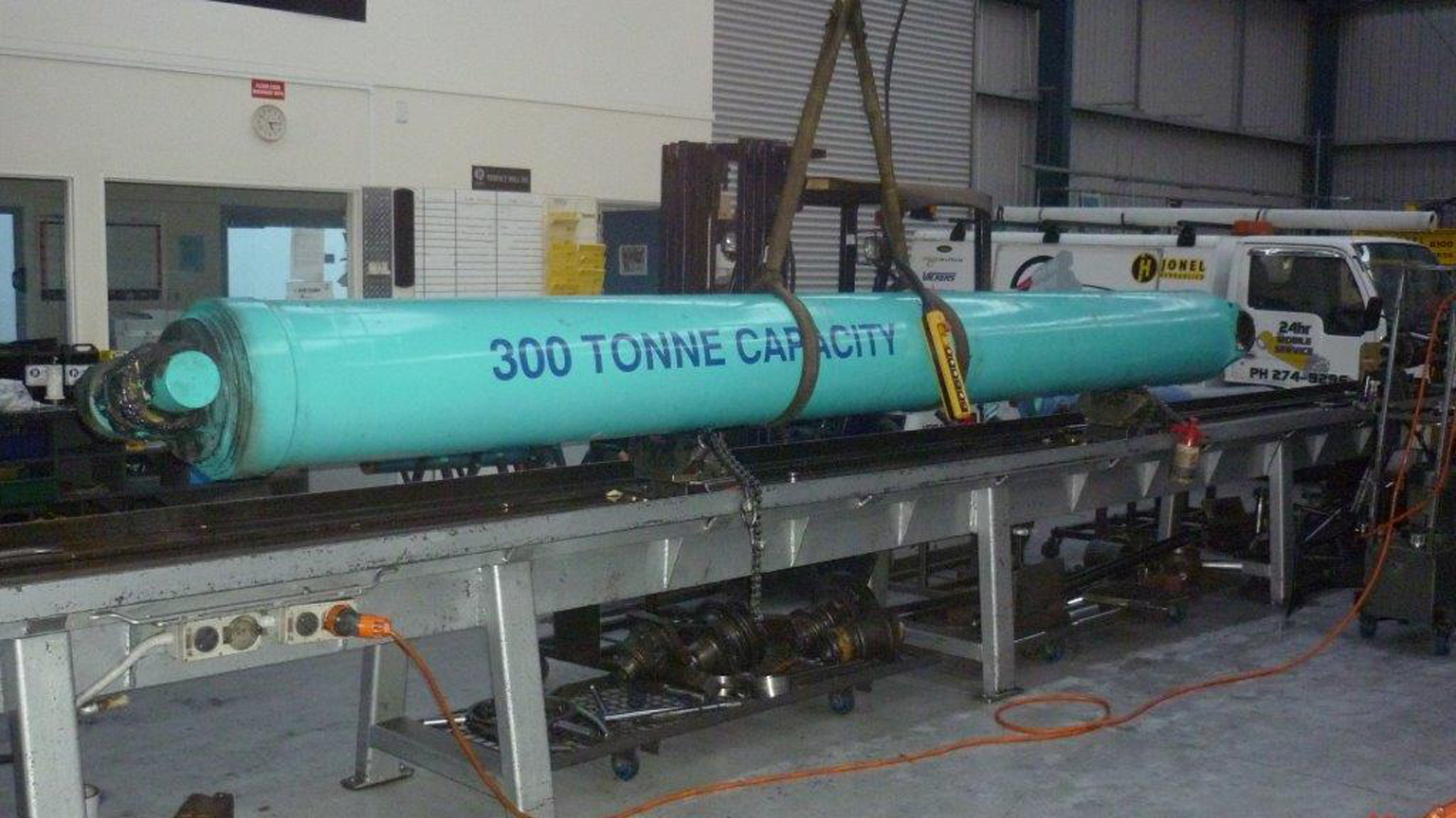

I was teaching at a customer when they told me about a large double-acting 10-in. bore crane cylinder, 16 ft long that was giving them problems. Twice a year they would run a test by lifting a large concrete block 12 in. off the ground and check to see if it drifted down more than ½ in. in two hours. The cylinder was extended about halfway out for the test.
The cylinder failed the test and they had the authorized dealer exchange it for a rebuilt unit.
They set the test up again on the new cylinder lifting the load 12 in.
When they went to check the results, they could not believe their eyes. The load was higher than the original 12-in. height. They set the test up again and now it failed. They wondered if the change in the weather had anything to do with it. It was raining when they set up the first test and sunny when they checked it. They set up the second test in the sun and it was raining when they went to check it.
