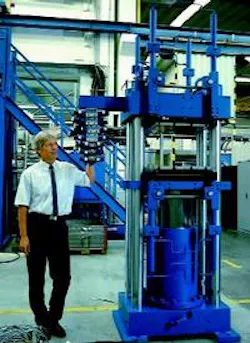

Man and machine — Engineering manager Richard Müssler explains that each of the 400 rubber injection molding machines produced every year by Maplan is custom engineered, and no two are identical.
