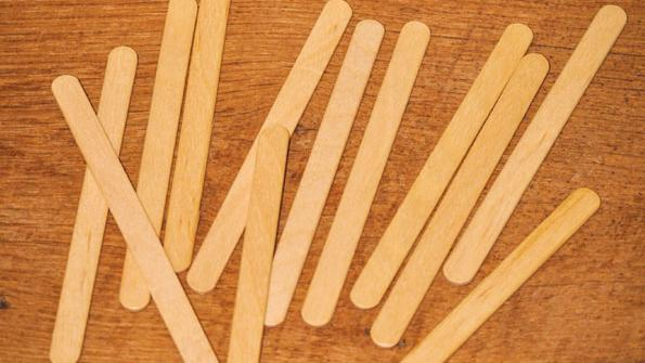

Most of us call them Popsicle sticks. More correctly, they’re called ice-pop sticks. But whatever you call them, John Lewis Industries Ltd., La Tuque, Canada, has been making ice-cream sticks (as they call them) since 1920 and now produces more than 26 million of them a day. Not surprisingly, the company also produces tongue depressors for the medical industry and coffee stirrers and wooden sticks for hobbies and crafts. Roughly 85% of Lewis’s output is exported to countries around the world.
The sticks are peeled from Eastern Canadian white birch, which is used primarily for its color, rigidity, and neutrality of smell and taste. John Lewis Industries is a stickler for environmental responsibility. The company draws upon sustainable forestry certified by the Forest Stewardship Council. And, of course, it has an eye on energy conservation. Bark from the harvested trees is burned to generate steam for the plant’s use.
