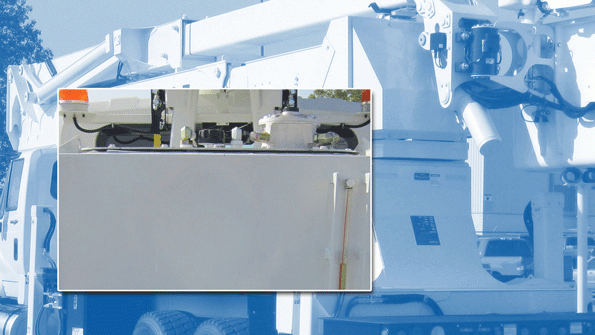

This 109-gallon capacity hydraulic oil reservoir is fabricated from aluminized steel and is used in an aerial work platform bucket truck. It includes a sight gage, filler-breather, and filter.
