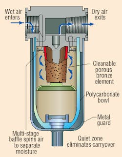

Figure 2. Cutaway view of air flow through compressed air point-of-use filter.
Many filter manufacturers will define the expected pressure loss and dirt holding capacity, using curves related to pressure and flow. Therefore, particle-removal filters should be selected based on acceptable pressure drop - and pipe-connection size. A typical pressure drop through such filters would be between 1 and 5 psig. A filter with larger body size will produce less initial pressure loss and provide longer operating life than a smaller size filter with the same removal ratings. The charts in Figure 1 compare pressure drop through several particulate filters that all have identical 5-µm removal capacity.
Most point-of-use filters claim to remove condensed water, typically via a form of cyclone separator at their inlet end, Figure 2. The water-removal efficiency of such filters is very dependent on the incoming air velocity. Therefore, these filters must be matched to the intended airflow, rather than acceptable pressure drop. If the filter is intended to remove moisture, an integral automatic float-type drain should be provided to periodically remove accumulated liquids from the filter bowl. Generally, such filters have transparent polycarbonate bowls, which allow easy visual inspection of the sump level. Numerous chemicals can attack this plastic material and it only performs well at pressures below 150 psig and temperatures between 40° and 120° F. A metal bowl may be required when the filter could be subjected to conditions outside those limits, as well as when synthetic compressor lubricants, which often contain chemicals that are harmful to polycarbonate, are present.

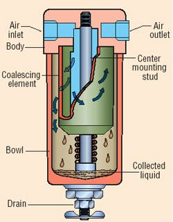

Figure 3. Cutaway view of air flow through typical coalescing compressed air filter.
Most oil entrained in a compressed air stream, as well as some of the condensed water, will be in the form of mists or aerosols that can pass through the openings in standard airline filters. Air for instruments, spray painting, and bulk-material conveying frequently requires the removal of such droplets. Coalescing-type filters, Figure 3, will accomplish this job. Aerosol carryover through such filters is commonly stated as parts per million (ppm) of oil vs. air by weight and will range from 1 to as little as 0.01 ppm.
Coalescing filters are often rated to remove aerosols that are substantially smaller than the nominal size of the smallest solid particle that would be captured. Some models offer dual-stage filtration; the first removes solid particulates to protect the coalescing element in the second stage. Because all coalescing filters create a greater restriction to the airflow, pressure losses will be higher than those of conventional compressed air filters. Coalescing filters have an initial (or dry) pressure drop and a working (or saturated) pressure drop, both based on pressure and flow rate. The effective removal efficiency of such filters depends greatly on the air velocity passing through the filter assembly. Therefore, choose a coalescing filter based on acceptable oil carryover, expected airflow rate, and pipe-connection size. A coalescing filter rated at 0.1 ppm will typically have a clean, wetted pressure drop between 2 and 5 psig, while a high-efficiency filter rated at 0.01 ppm can cause as much as 10 psig drop once it becomes wetted or fully saturated during service, Figure 4.

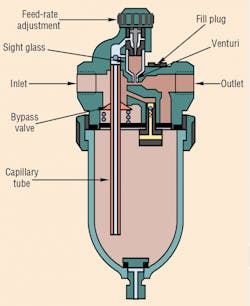

Figure 8. Cross-section of typical airline lubricator. Click on image for larger view.
Many pneumatic system components and almost all pneumatic tools perform better when lubricated with oil. Injecting an oil mist into the air-stream which powers them can continuously lubricate valves, cylinders, and air motors for proper operation and long service life. Locating the lubricator properly in the pipeline is important to ensure that the correct amount of lubrication reaches each device. Too little oil can allow excessive wear and cause premature failure. Excessive oil in the pipeline is wasteful and can become a contaminant in the ambient area as it is carried out of tools and valves by the air exhaust. Intermittent lubrication may be the worst condition of all because the oil film can dry out and form sludge or varnish on the internal surfaces of the equipment.
Fig. 9. Pressure drop through small and large lubricators rises dramatically as flow increases.
Airline lubricators, Figure 8, meter oil from a reservoir into the moving air-stream. As high-velocity air passes through a venturi, it draws the oil up and through a capillary, then drips it into the air-stream. The moving air breaks up the oil into a mist (small droplets) or fog (larger droplets), which is then carried downstream into the air-powered device. In a typical lubricator, all of the air passes through the venturi during low-flow conditions. Under higher flow conditions, a spring-loaded bypass valve opens to direct the excess flow around the venturi to a point downstream where it rejoins the lubricated flow. A manual adjusting valve sets the oil drip-rate and a sight glass enables the operator to monitor the output. A fill plug provides access to refill the reservoir, which typically is made from polycarbonate. The same precautions about polycarbonate apply to lubricators as they do to airline filters.
Lubricators typically have a larger flow range than an equivalent size regulator or filter, but their pressure drop increases quite rapidly as flow increases, Figure 9. The acceptable pressure loss for a lubricator is normally considered to be 3 to 7 psig. Lubricators are generally selected based on pipe connection size, oil reservoir capacity, and acceptable pressure loss versus flow rate (many manufacturers publish a minimum flow rate at which the venturi will function properly). Remember to account for this added downstream pressure loss when setting the pressure regulator. Set it at desired use pressure plus lubricator loss (drop).

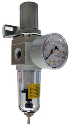

Manufacturers frequently preassemble filters, regulators, and lubricators to form combination units, Figure 10. They are packaged together as common body sizes with common connection port sizes. Interconnections may be via threaded nipples or modular face connectors. The modular connectors allow easy removal of components for servicing or cleaning. In addition, some manufacturers combine filters and regulators in stacked assemblies where the filter head becomes the regulator body. The components share common inlet and outlet connections, which makes the assembly very compact.
Figure 10b. Compact filter-regulator combines both components into a single housing to save space.
Such packaged units, whether F-R only or complete F-R-L, are practical choices for most industrial applications. The selection criteria are the same as with any of the individual components, except that the combined pressure and flow performance becomes the only consideration. Note that when critical requirements dictate the use of specialty filters or precision regulators, the assembly probably must be made up of individual selections and connected with pipe nipples.
