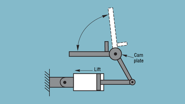

When specified correctly, cylinder cushions do their job of protecting a cylinder and its load against damaging impact at the end of a stroke. However, if the external application changes — say, by increasing the load, the speed, or both — the original cushions may not be able to perform acceptably under the new conditions.
We ran into this situation on a welding line for truck wheels. Four of the stations used cushioned lift cylinders to swing the heavy wheels slowly between horizontal and almost vertical positions. Unfortunately, the equipment was configured to put the cylinder at a 4:1 mechanical disadvantage, and when our production people had to speed up the system to fill new orders, the additional momentum became a cushion cruncher. We were replacing a cylinder weekly.
We considered external shock absorbers, but the cost of rebuilding the framework was prohibitive. We investigated big rotary cams and deceleration valves, but there was no room to install them.
However, there was a thin rotary cam plate at the pivot point that was used to trip some limit switches, and someone remembered reading about electronically operated flow controls. Maybe we could add other limit switches to sequence high and low voltages to such a flow control.
As we suspected, the electronic valves were expensive, and we had a battle to get our hands on a single unit to try to prove our point. We installed the flow control in the tank line and ran the cylinder at full speed for 80% of its stroke; then we ramped down via the meter-out flow control over the last 20% until the cushion could handle the final stop.
The setup worked like a charm, and adjusting speed with a twist of a potentiometer was a pleasure. Too much of a pleasure, as it turned out. We had half the guys in the shop coming over to play with the new controls — zooming up and zooming down — until we caught a couple of them plotting an attempt to launch one of the wheels across the aisle. The pot wound up in a locked box with a shatterproof glass cover, so all could see the settings but not change them.
After this first success, it was easy to get and install electronic flow control valves on the other stations. Four years later, we still haven’t lost a valve—or another cylinder.
