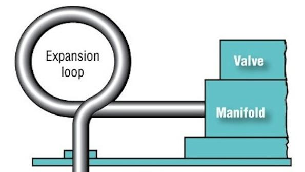

Tank or return lines often are the orphans of hydraulic design procedures. What can go wrong in a piece of pipe that only has to carry low-pressure fluid back to the reservoir? Here’s one story.
The reason: that valve operated the toggle-locking cylinder on a large-tonnage die casting machine. When the valve shifted to unlock the toggle, a momentary spring-snapping action accelerated fluid in the tank line to more than 120 ft/sec. Because kinetic energy is proportional to velocity squared, the eight-fold increase over design velocity resulted in an energy level 64 times higher. The weakest link in the return chain was the right-angle fitting and that was where we got consistent leakage and even some breakage.
After half a dozen different standard fittings failed to solve this problem, we decided to take a page out of the French horn designer’s book and put in an expansion loop of tubing. It looked odd, but it halted our daily breakdowns. The loop lasted six months or longer.One of the foremen in the area decided that if one loop was good, more would be better. He got his best pipefitter and the biggest bend dies in the shop. They turned a length of tubing into a triple-loop pigtail that lasted for years on that die casting machine.
